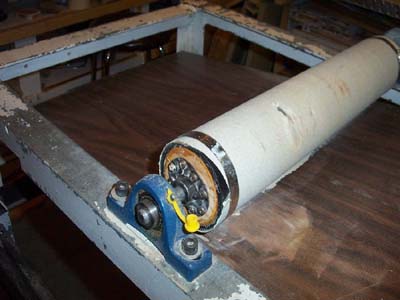

Nelson, i built my drum sander using a 1/2hp mmotor, belt, pulley, pillow block bearings, 1/2" steel rod for the shaft and ABS 3 " DIA pipe for the drum. The hardest part was the lever handle which i had someone weld for me. Your description sounds a little harder to achieve but maybe someone else with similar experience might show up. but if your interested in seeing my set up, i'll throw in a couple of pics! hope this helps!

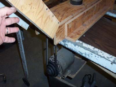

Ok G'mornin' JP, I'm back with pics of my drum sander.
The table under the drum swivels on a bar at one end of of the sander and a 1/2" threaded rod going through 2 bolts that are welded to 2 diferent plates andact as a lever mechanism to raise or lower the feed table
The motor is suspended with springs and swings on a bolted metal plate o each sideSerge Poirier38782.2802430556
